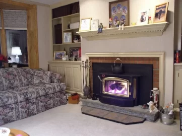

I'm hoping to hear if anyone has found a good spot on the Regency-- or for practical suggestions for those that have faced this issue with other inserts. Neither the owner's manual nor my dealer have been much help. Many thanks. H.
I have mine in the upper right corenr- as seen in the photos. I also experimented with other positions on the front and it reads the same. Make sure it is low enough so the air from the blower does not blow onto it and cool it.
How do you like your I3100?
I placed my thermometer above the door opening, left side (2400i). The blower makes it drop close to 175 deg. So just keep in mind that if your blower is on and it reads 300 deg it is actually 475. I double-checked it with an infrared gun. This was the response that regency gave me

I just ordered a deep fryer thermometer that reads up to 800 deg. It has a long 12" stem. I'm going to place that between the top plate and the stove to see if I get a better reading. I will post the results

  • Thermometer Placement on Regency i3100 insert
