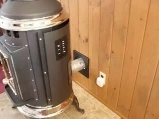

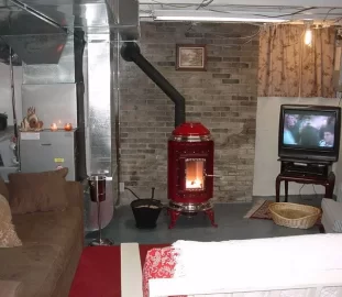

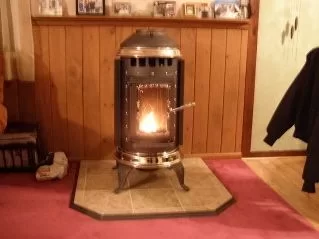

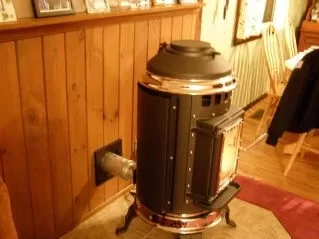

Had our Thelin Parlour Installed today finally and it is burning great.
It was done by The Hearth Shoppe in Belvidere NJ, I highly reccomend them.

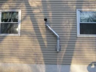

The exhaust is 4" out & up 5 feet, it is offset so that the stove went exactly
where we wanted it, which was closer than 4 feet from an opening window.
I ran it on medium for about 4 hours and the burning smell is gone already.
Bob

Heres how we did the exhaust to comply with state regulations, Thelin's
requirements and our choice on where to place the stove.
