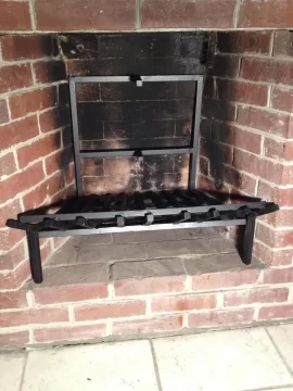

The perfect fit
My upstairs bedroom mini Rumford:)
  • The perfect fit
Hi, Thank You! I submitted a patent for this design and build them as a side business. I would like to see the opinions of the folks who use their fireplaces for beautiful winter scenery:) I made a bunch of prototypes and my latest design rocks the Rumfords=easy to start, self feeding, produces lots of heat, and looks beautiful!
Steve

The rumford design is taller (openings are square or almost) and shallow. They work best when wood is set up on end to create tall flames and warm up the side brick surfaces. The chimneys are necked down to create the bernoulli effect which sucks the smoke out but does not over evacuate the heat. You do not have to use a grate if you like stoking, restacking, ash removal after almost every fire, and embrace the danger of a log tipping out of the firebox. That website (www.rumford.com) is very helpful and has some good data but keep in mind, they DO NOT have any data utilizing my new grate design.
