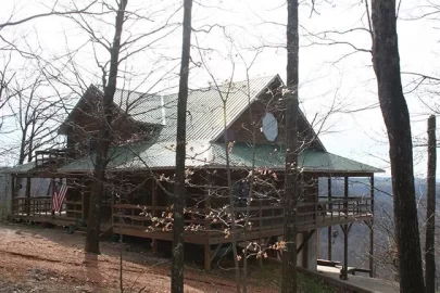

  • [Hearth.com] The Perennial Newbie Request

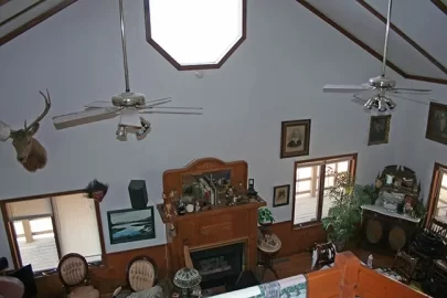

Thanks for the pix--that helps a lot. Based on the relationship of the roofline to the window, I'd be looking hard at putting the stove in the location between the soon-to-be-history fireplace and the window. That would put your stack to the lee side of the house, just off the ridge, instead of right up the ridgeline, or giving you a jog in the stovepipe. Actually, I'm just making an assumption about the lee side based on your hills--I could be wrong there. But if that's the case, it would make for a more efficient setup for a lot of reasons, and it would blend in more attractively with the roofline as well. If I were in a `oh, it's just money, anyway' mood, I'd probably ask wiser minds than mine if it were possible to run copper jacketing held by matching brads up the stovepipe inside, just to give it that visual zing! thing.

Have you thought about putting the stove in the corner (in the picture where the chest is placed diagonally at the moment)? You could get a straight up chimney there, and corners are common locations used for wood stoves.
Two votes for the corner. I have a corner installation straight out the back of the stove with a tee and up two stories. Cleaning from the bottom is a cinch. The 2 foot horiz run from the stove to the tee is always clean. Pretty much just run the shop vac from the tee into the horiz pipe and wiggle it around. Disconnected the stove after two years burning seasoned oak and maple and it was clean. All I ever got out of the pipe was a little white ash. I would consider the corner install than you won't have the pipe in front of that awesome window or deal with bends. Just my opinion. :)

Beautiful home and location.. spent some time in NW AR hunting the elusive quartz crystal in the Mt. Ida area. Found it to be very similar to the mountains and hills here in NY.

I had planned a corner location, and my last minute change was with an up-against-the-wall-in-the-middle location. THought I was going to be very unhappy with that spot, but as it turns out, I love it. Easier for us all to congregate around it, and easier to access side door. YMMV.
I am jumping to conclusions here, which is my favorite form of exercise. I thought that the house was sited with the long axis to the south, which would put the window to the west. (It is hard to tell otherwise, because your sun is shining down from overhead! which I can't tell you how silly that looks, but a topic for another thread, that. I assumed south would be the lee because of the way its sited on the hill, that the wind would come over the ridge and pull the smoke down, away from the house, if the stovepipe was on the downwind side, and keep it out of any vortices created by the ridge. Probably just a minor issue, that--but I've noticed that the longer I hang out on the forums, the more I think in air currents.
Also, the stovepipe sticking up over the ridgeline from the other side would be a nice balancing touch, but installed on the (presumed) north, it would visually break those long sweeping intersecting planes of roofs (rooves?)
Time to pull out the photoshop and start fiddling around. If you like the look of the stovepipe on the near side, the trade-off in ease and safety of installing and servicing the stack might off-set any advantage gained in having the stovepipe to the presumed lee side.

If the by-the-stairs location is appealing in all other aspects, how hard would it be to relocate the furnace air intake? And would that necessarily be a problem, if you're not running the furnace when you're heating with wood, or if you want to use the fan-only function of the furnace to redistribute heat in the house?

Just my $ 0.02 worth, but I'd vote for an interior installation with the pipe running up the middle of the window or possibly a 45 and 45 degree elbow at the top. if you run it inside you don't have to use double wall and it would be much cheaper, and you have the added heat from the pipe. I did a through the cealing installation through the attic and near the peak of the roof, running double wall going through the cealing and out the roof. When i clean it, i have a slip pipe above the first section and can raise the pipe or take off a section. I put a plastic bag on the bottom and ram the pipe from above. or, I have the choice from doing it from the bottom doing basicly the same thing. Granted i don't have a situation like yours but it appears the window provides mostly light anyway, not much of a view. I'd also get a size bigger stove than you need. You can always run a less than full load. Or, you can run a full load and burn it slower, as long as you don't make creasote.
jmho....by the way, have an extra room? Love the house. You are one lucky man!

Firebug, The great room in my home is similar to yours but my ceiling is not quite as high nor my roof quite so steep. My stove wood stove is located against the back wall (with code compliant clearances) and centered under the ridge of the roof - appears to be about the same location as your current fireplace. My stove looks about as nice as possible in this location and is very effective heating the great room. Your two ceiling fans will be most effective at circulating the heat in that room. Both of my ceiling fans run 24/7 during the burning months. They are on low speed and blow "up".
This stove location allows me to have stovepipe and chimney in a straight line (no bends) through the ridge of the roof. The chimney is enclosed in a chase where it penetrates the ridge. This exterior chase structure prevents any water penetration. Last fall, during a heavy rain with 40 - 50 mph winds the chase prevented any water penetration.
As another poster suggested, I wouldn't worry about the stove pipe running in front of the octagonal window. I favor a symmetrical look in home design and in your lovely home (love the design and location) the stove would be centered against the wall and the stove pipe would be centered relative to the octagonal window. The stove pipe would penetrate the ceiling at its highest point. To me, the symmetry of the installation would be simple and balanced. I like that.
I would not be so bold as to suggest my way is the best way. Just explaining my installation and how pleased I am with the results. I am also very happy with the stove choice I made. It is quite effective providing enough heat to my 1,700 sq. ft. home which is located in an unprotected high wind area. I burn about 4 full cords of seasoned ash and cherry each year. You should burn less than that in Arkansas.

snowleapord, I'll address this to firebug so it will not constitute too much of a thread hijack. My roof is engineered to Region 6 (the heaviest?) snow load requirements. In addition to the engineering, I ordered extra trusses and placed them all on 16" rather than 24" centers.
Firebug, The main structure of my roof is manufactured trusses so a structural ridge beam was not a concern. However, if your roof is constructed of a ridge beam with rafters, and it appears it might be, I would strongly recommend you or those you hire consult a building engineer before cutting a ridge beam. That modification to the roof structure is do-able and would PROBABLY not be too much of an expense. The roof's proper structural strength must be maintained.
Whatever you decide to do, my recommendation is to do the installation your favorite way. If your favorite way costs a couple of extra dollars and involves extra work, it is my opinion that spending the extra dollars and doing the extra work, within reason, at the beginning is worth it. There have been times at a younger age when I cut corners to save time and/or money and five years later was kicking myself in the butt for being so stupid.
