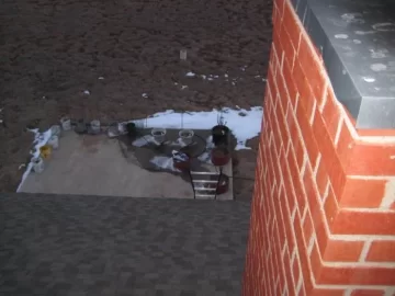

Tboy, give us a picture. We'll tell you if you should man up or remain a boy.

Okay, here's my try to put in a photo. The patio is a long way down there! BTW, the patio is 20 feet left to right!
