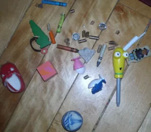

Then...while vacuuming behind the stove...I shook the outside air intake pipe...and heard a strange rattle. ( I do not have the pipe outside...it is inside, I know I know...)
I take off the pipe and shake it....and discovered that my biggest threat are my 3 and 4 year old girls. See below for the contents of the OAK. Gee do you think this might be an issue
