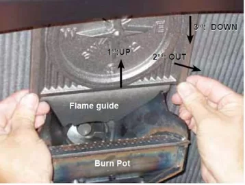

3650 said:pellets keep pushing it away from firewall. flames ride up behind it. anyone else have this issue?
3650 said:this is a 2004 fs accentra. the flame guide on this model is removable...nothing sits on top of it. it is being pushed away from the back of the stove by the pellets.
3650 said:poor design which is probably why they changed it to the type in the pic.

hmmm ...if the loose flame guide wasnt a poor design why did they incorporate it into the medalion making it one piece?

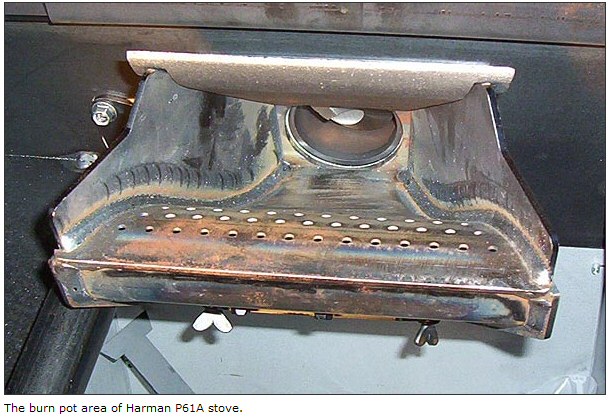

That said, I will make a 2nd request from the OP for a pic of the part(s) in question.
Avtek said:My Accentra FS (free standing) had the moving flame guide issue my first year of burning. Turned out to be slightly contacting the tip of the auger during it's feed cycle. How ever never saw flames behind the guide. May be erosion at the bottom of the flame guide or a warping of the flame guide in your unit.
