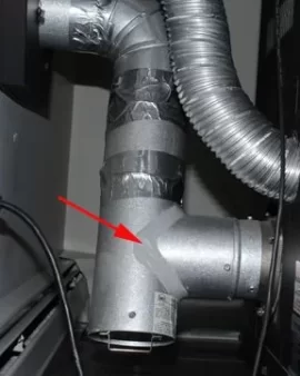

jaudet71 said:...When I had my Harman XXV on my hearth and into the chimney it was off the chart. Even out the wall with a one foot rise on the inside and straight out outside it was over spec.
...I used an internal baffle to cause enough obstruction to bring it into spec...
jaudet71 said:I used a piece of stove pipe squeezed or bent in to a broad point. Put the point towards the air flow so it doesn't catch ashes. I put mine where the arrow points due to the tee. When I check the tee access point, it is clean as a whistle every time. Leave at least part of it wide to wedge it in place so it stays put. You may need to experiment some and you can put it anywhere you have access.
