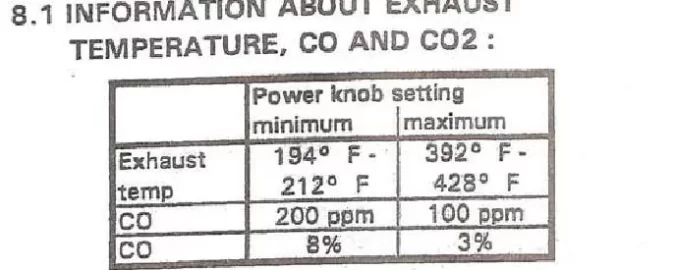

I have a temp of approx 80c on the outer lining of my exhaust just before it enters the thimble. What are the temps others are experiencing? I contacted selkirk a few minutes ago and they had no clue what is acceptable for their type L vents.
L vent is rated for 450*f (inner liner) continuous iirc
I measured 120F (49C) on my Duravent with my 25-PDVC running at a setting of 5 for 1/2 hour. The front of the stove was at 375F (190C) at the time so I assume the exhaust gases were at least that hot.
