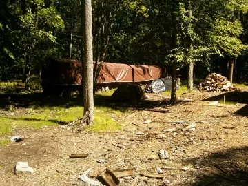

Below is a poor picture of my tarped wood. On top of the double row stack under the tarp is a 5/12 peek roof frame made from 2X2. The frames are 4 ft wide and 8 ft long. The frame has web strapping ***** around it. This frame sits on top of the wood. It is the support for the tarps, so the tarps don't touch the sharp wood and rip. Also the strapping stops the snow from sagging the tarp.
The tarps are tied down with adjustable tent ropes and small bungee.
It's not perfect but after a lot of tarp designs this is my best so far. It can take a lot of high wind and rarely pulls the stakes out. The plan is to someday make a similar hard roof design.

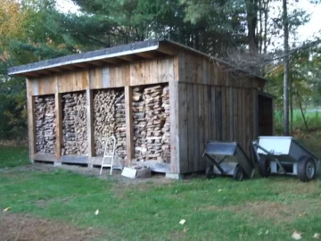

Here's my solution to the pain of tarping . . . ;)

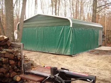

here's mine

How much did that run you, if you don't mind my asking?

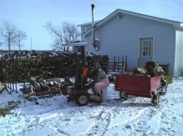

Here mine! :lol:

It's 18 X 21. I had 1 ft of height added and the end eves done to "square" off for easier of mounting the tarps (which was extra cost). $1195 installed.
I had the tarps custom made for the size and quality I "wanted" which was another couple hundred....including bungee cord, eye bolts, and S hooks.
I made the door out of an old sign I bought at an auction.
I was going to build a 12 x 20 PT one but by the time I figured the cost and my labor to do the job, this turned out to be a better choice (for me anyway). I got to drink cold ones while watching it being put up too :-) May not have been the absolute "cheapest" way to do it but I am extremely satisfied with it. Right now, about 12+ full cords in it..... tarps are rolled up for summer.

That's an excellent price. Who did you go through? (I'm assuming that will hold up under a lot of snow.)
I'm never priced it out but I would have assumed it would have been twice that.

I bought it through a local dealer but Carolina Carports is who came and put it up. Mine does have the "horizontal" ribs running the roof. The vertical ribs are stronger and in turn cost more. Mine is the heavier gauge steel and also has the supports on every upright corner and under the center ridge(some do not have these)
I know about snow load and keep my eye on it, but there are many of these carports in my area and we have had some "banner" years of snowfall lately and I have only seen a couple fail.

Varna, those do indeed make great wood sheds. However, I would not put tarps around it. Better to be open on the sides all the time. Don't have to worry about rain or snow hitting the sides of the wood stacks. That runs off and is usually completely dry within 24 hours after a rain.
