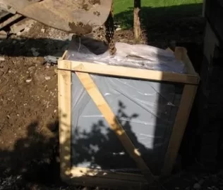

  • [Hearth.com] Tarm Installed!

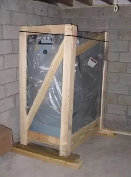

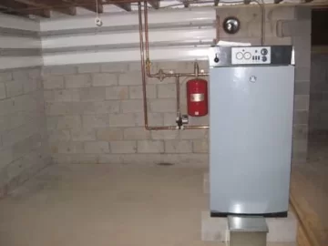

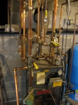

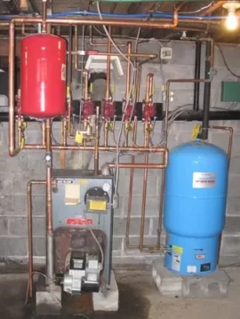

Congrats...I am less than a week away from a test fire on mine. How about a few pictures of the behind-the-tarm piping? That's the last step I need to accomplish and want to see how some other folks plumbed theirs.

Bravo! And I thought I was going wild taking on my own variations of a similar project- at least I didn't have to blow a hole in the wall
I was on pins and needles when we started opening up the wall. Of course the hole was 2x the size of the one in the picture once we finished. Luckily my neighbor had a JD 410E backhoe to lower the boiler into the basement - a very cool piece of equipment... The Tarm model is the Solo Plus 40 integrated with the existing oil boiler as secondary. Will be looking at storage for next year.
