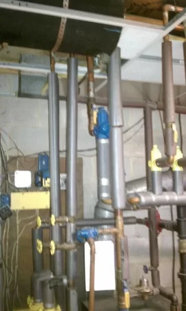

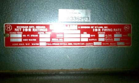

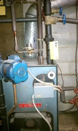

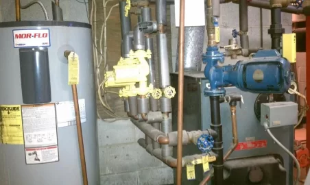

I've posted a couple pics of the furnace, including one in which a copper pipe running from the top of the furnace runs up to a tank mounted in the ceiling. Hopefully the web of pipes might make a bit more sense to some of you than they do to me.
What I'd really like to know is if it would be ok (and how) to disable the tankless hot water so that the furnace only runs for heat. I'd like to think that would dramatically cut down on my oil usage.
