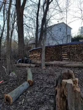

I have some more free wood from the previous storm but need to figure out how to get it down... Conveniently right above my wood stacks.
I debranched all the bottom, then was able to notch and slowly lower down two 4ft logs. Unfortunately it is still about 14"x20'+ tall, now 1" from my oak stack. I tied about 8' up and tried pulling by hand; I could only give it a little shake.
Anyone see a convenient option? It's not too accessible except by foot.
It's leaning up against a large maple in range of my house. I'd prefer to get all the pressure off the living one (and get a little firewood at the same time).

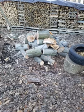

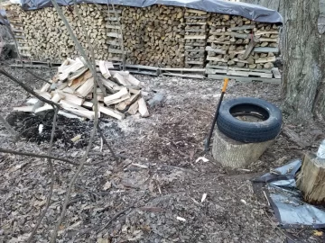

Thanks for the tips... I ended up testing the strength of the oak stack and it held up. Put a hinge another 8' up, then tied it to my Ridgeline to crack the hinge from a distance. After that I put a hinge to bend it back toward the stack. I could pull it by hand. Repeated 3 times and slowly brought the rest of it down.
Not the easiest score but got it all finished and split in about 3 hours. Tooks some time to rip off loads of vines and branches. Looks like just under 1/4 cord with all the junk pieces tossed.
