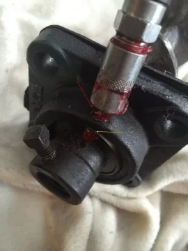

These auger bearings were dry! See dry channel in pics below. Pellet stove is 2009 and auger and bearings were never removed until now!
Here we pump Red High temp grease from a cartridge into the alemite fitting using a grease gun purchased from Lowes or Home Depot.
How often do you apply the red stuff.
Pic 1 - Bottom Auger with BONE dry bearing! See empty grease channel.
Pic 2 - Grease gun setup
Pic 3 - Squeezing in the red grease
Pic 4 - filling the channel
Pic 5 - Greased auger - sprayed with "Dry Moly" after wire wheel brushing and grinding rough spots
Pic 6 - Align Augers and check to see if they turn freely. Zerk fitting on left for easy access.
Pic 7 - New Hi Quality auger motors
Pic 8 - Top auger in hopper
Click pics to Enlarge:
See Yellow and red arrows!
