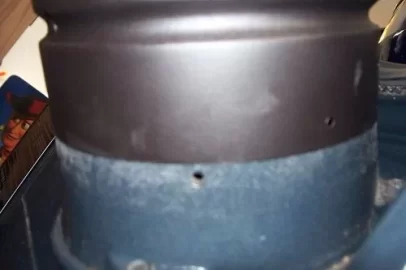

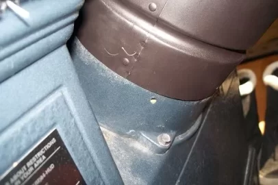

Hello All,
I have a Hearthstone Phoenix and am upgrading to Supervent DSP. I've connected the telescoping piece to the stove pipe adapter at the ceiling box. Problem now is the 45 DSP connector will not fit (easily) on the stove collar. Do I need the adapter for the stove. I contacted Heartstone on this and they said"I have what I need." Before I proceed with the install , I thought I'd get some trusted advice. attached is the 45 at the collar. As you can see the holes are far off. it will only fit about .25"
