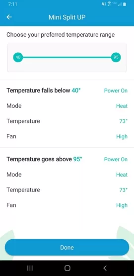

I'm pretty sure the Cielo Breeze Plus thermostat units I use on my mini splits could do just what your looking for. These are IR based and just mimicking the remote so not sure if they work on a wired thermostat. They have a mode where you can have it make adjustments based on a range of setpoint. Here is a screenshot from the ap.
[Hearth.com] Super efficient heatpump thermostat? [Hearth.com] Super efficient heatpump thermostat?
