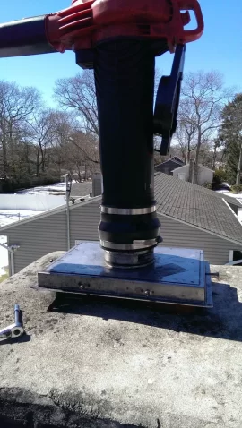

43 degrees, I'm off today and why not? Stopped at Home Dopey to get a rubber coupling for a better seal. Bamf, like a champ.

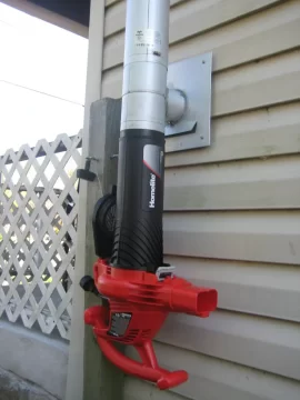

looks like same HD Blower? mine fits right inside of the exhaust..

Believe I got it from Home Dopey's website. It was slightly to small too cleanly fit over my cap.

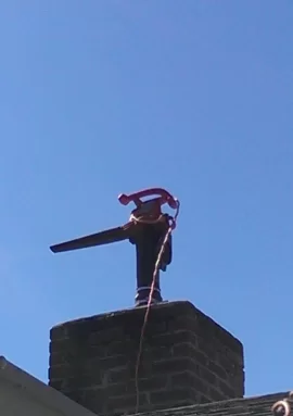

I don't get the leaf blower thing. I need to read up on it. But isn't it blowing a ton of soot into the house/stove?
You use the leaf vac end. So it sucks it out.
Look at which end is connected to the vent.
  • Sunny, warm and little leaf blower action
Ah!!!!!!!!!! You know, In that last pic I thought "Isn't that the vac end", but I thought it might not be strong enough to get enough out...
I aim it into my back yard. Haha
Do you guys have a Model number so I can pick up one from the website? I have 4" vent - will that work with that vac or do I need an adapter?

I have a 4" vent and the blower fits nice/snug inside the vent.. No Adapter needed.
Has a Beveled end that fits perfect into 4". can see in the picture. Sunny, warm and little leaf blower action

I have a 4" liner, but the tube didn't quite fit over the stainless cap. I bought the rubber adapter from Home Dopey. It was in the PVC section, was like 7 bucks and came with the clamps. You can see it in the first post picture.
if you have same blower as I do and 4" exhaust. I'm surprised it did not fit INSIDE your exhaust pipe..
Yep, wouldn't fit. The flex liner might have a slightly different diameter.
