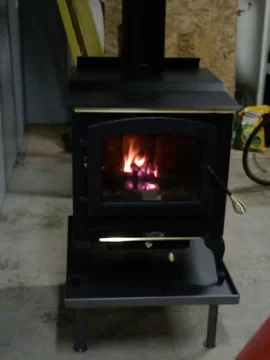

Hello. I need a wood stove to heat a 1,800 sq' shop in northeastern Utah. Cost is an issue, but looks are not. Any suggestions on high heat low cost stove?
Greetings Gavin. The Englander 30NC from Lowes or Home Depot at around $1000 is probably one of the best candidates for value in a big stove. Several folks here are burning in this big stove and quite happy with it.
I agree with BG. I have one in my 1440 sq ft pole barn & I'm lovin it.
  • [Hearth.com] Suggestions for work shop wood stove
Englander!
Good luck,
Bill
