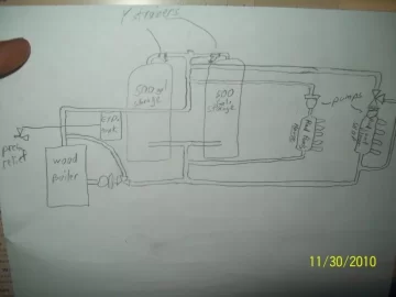

Hello All
I am starting on my 2 vertical 500 gallon propane tanks for storage.
I understand I need water in and out the top and bottom, I am going with 2" to cut velocity to reduce stirring. I'm also putting a domestic coil in a 4" tapping.
What other tappings are needed, and where, what about any extras you now wish you had put in? How about aquastat well and their position?
I'm heating it with a Tarm 2000 @ just over 100K btu output.
Thanks
Wade
