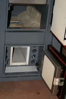

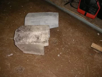

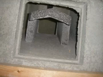

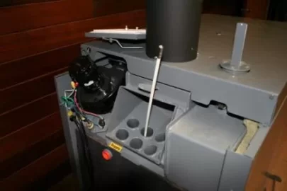

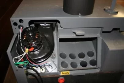

Having operated a gasification boiler for near to 30 years and over that time, refractory repairs have worked out to around $30.00 per year! The prospective that interests me in some of the new units is how difficult and how expensive will it be to maintain the refractory?
One of the boilers that looks interesting is the " Vigas ". Its refractory nozzle looks easy to replace and if necessary, would not be to hard to make.
http://www.ahona.com/Vigas/Vigas Manual Feb 2010.pdf Section 14.3 shows this nozzle. Below is a picture of a Jetsream nozzle that is easy to make and replace.
Another boiler that again looks interesting from the refractory standpoint is the "Empyre Elite 100". A very simple system of refractory brick in the fire box and secondary burn chamber. Pictures attached.
Tom in Maine would be able to tell you if these boilers would be compatible with his heat storage tanks.
