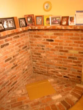

What exactly are the "confines of the space" where the stove will go...just so we know what you have to work with.

Here is the hearth area that was already existing in my basement, and by default (unless I want to start all over, which I don't is were a stove needs to fit. The hearth measures about 60 inches in depth from the back of the wall to the laminate flooring. The brick do not have and inch of open air space behind them and according to my local builing inspector (and from I can tell as well) don't provide additional fire protection. Basically, my clearances are from the wall itself behind the brick (5 inches). I would prefer to back a stove into the corner so that the door faces the main part of the room. Another issue that I have that is that if doing so, to keep 16" in the the front the pipe exit from the stove and the exit in my exterior wall (see fashionable plate covering hole!!) won't line up. Can a guy work around that or not. The other option is to have the back of the stove against the outside wall. Sorry this is so difficult to explain, but hopefully the photo will help. Any and all suggestions are welcome.
Thanks!!

there is nothing wrong with buying a used stove as long as you do your homework and know what you are buying. In regards to that Country I provided the link on, I would email him and ask if there is any type of I.D. data plaque on the back of the stove, I know my c160 has one on it and it tells the model number and serial number, and perhaps the mfg date, with this info you can get a idea of how old it is and how much use it has had, also inspect the stove for signs of over firing, look insid to see if the baffles that hold the upper firebricks are warped, or if the secondary burn tubes are warped, look around the flue opening at top of stove for any cracks. also ask that seller if he has all the exhaust/chimney pipe with it
There are a couple articles on purchasing a used stove in the hearth wiki, they go into pretty good detail about what to look for. One key thing to insist on is that the label on the back be present and legible, it should have all the certification info on it that your building inspector / insurance co. would need, and a minimal clearance chart. It is helpful if the person has the actual manual, but not vital since you can get manuals for most stoves online if the company is still in buisiness.
Otherwise look at that wiki article to see the "hardware" aspects of what you should look for.
