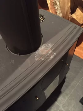

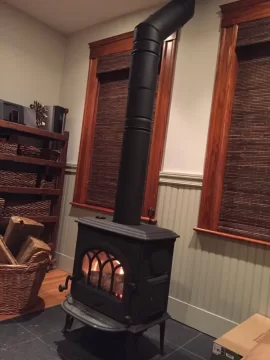

Hi. I wonder if anyone can help me understand this. I searched forum but no luck so far.
Jotul F3, double wall flue. Installed about 4 years ago. Our first wood burning stove...love it. But...
Since we had it installed it's given off a distinct metallic/chemical smell when first lit especially if not used for a couple of weeks. We did all the recommended staged burns to begin with. I assumed it was to do with the black coating "gassing off" initially. But it's still happening years after installing.
Second thing, possibly significant. Where the flue comes down into the living room it does a couple of 45 degree turns to get the stove away from the wall. I noticed some rust colored stains and occasionally see drops of water below these 45 degree turns. Initially I blamed the kids but now it dawns on me that this is probably rain water tracking down from the roof between the inner and outer skin of the flue. I'm wondering if the smell is caused by evaporating off some damp mustiness that accumulates between the walls of the flue. The smell goes away after about an hour's hot burn.
As I say, absolutely no smell of smoke. In fact, sometimes I open the front of the stove for a few seconds to get a little smoke smell into the room to mask the other smell.
Is this a normal thing? Is there some caulking that could be done to stop this? Or could it still be the stove coating gassing off?
Any guidance or opinions welcome. If there's a thread on this already please let me know.
Thanks
Ben.
Please see pics of stove and rusty stains on back of stove.
