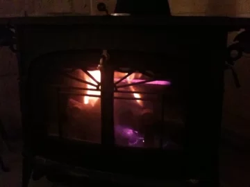

This evening I fired up the stove (it was idle for couple of
days due to warm weather) just like any other time. Nothing
different other that super clean firebox. I also want add
that this fall I put in a brand new ss cat. 45 min. into the
burn stovetop nice 650 cat probe 600, cat glowing nice
dull red. 2.5 hrs into the burn stovetop 650 cat probe 850
about 30 min ago stovetop 650 cat probe started to drop

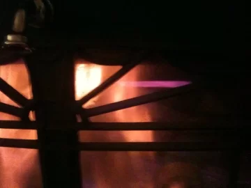

quite fast to about 400 (stall I believe) I had a little bit of
flame going in the box very lazy but not that hot flame (very
orangy) I needed to go outside for a bit and noticed a bit
of smoke out the pipe! (what the......) I surely had a cat
stall....
10 min later I come back into the house, no flame in the box
just lots of orange glow (not cat) looked at the probe it is sitting
at 300. I go outside and see no smoke at all....
What happened?
