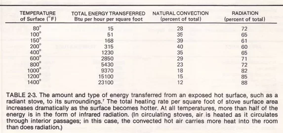

Your formula is only valid in a vacuum. In air, and at typical stove temps, only about 60-65% of the heat leaving a radiating surface actually leaves as radiant energy. The rest enters the room through convection transfer. You can feel this in many stoves (most notably steel or cast iron ones) when you close the bypass. That blast of heat you feel is convection at play. As the heat is further contained inside the firebox, it quickly gets conducted through the metal and to the surface, where is heats up the air surrounding the stove. Even without fans, the air will initially have enough of a cooling effect on the stove that surface temps will be stable for a short period before they begin to rise again.
The table below shows how much, and in what proportions, heat energy leaves a radiant heater. This is different for convection stoves, where the percentage of convective transfer is obviously much higher.
  • [Hearth.com] Stove temperature vs thermal radiation

Ah... that ain't my table. I plagiarized it from some third-rate university physicist, whose wacky notions regarding wood heat have been thoroughly discredited on this forum. Feel free to improve on it. :-)
