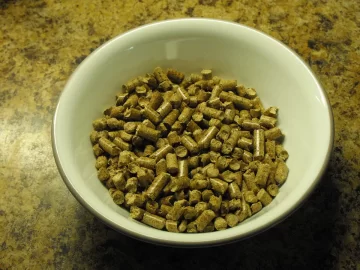

I have a Ravelli Dual 7 which is approx 5 months old. We are having a lot of problems with the auger becoming blocked at the top (at the area where the pellets will fall down the chute into the firebox).
The pellets seems to get ground into coarse powder (photos attached) which then causes the auger to become blocked and unable to rotate.
