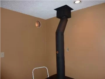

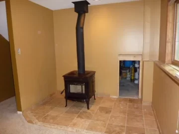

I am looking at buying a wood stove for my 1400 sqft cape cod home. This is going to (most likely) go into the basement which will eventually become the family room. This room is about 400 sqft and the stove would be directly across from the steps leading to the first floor. There are two stoves I like the PE alderlea T5 and the jotul oslo. Will either of these stoves cook us out of the room? I am hoping to heat the basement and first floor and any heat that might make it to the 2nd floor would be a bonus. The 1st floor is an open floorplan so I think the heat should circulate pretty well there. Thanks for any comments or suggestions.
