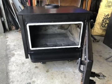

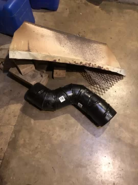

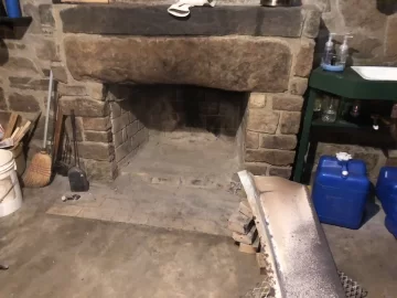

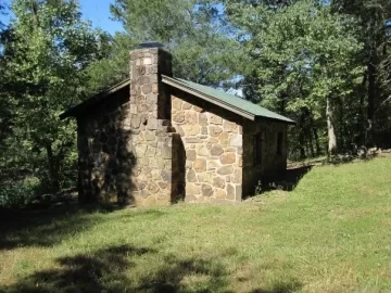

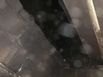

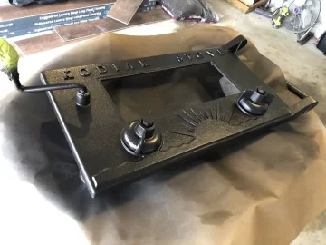

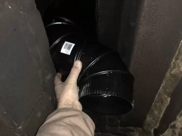

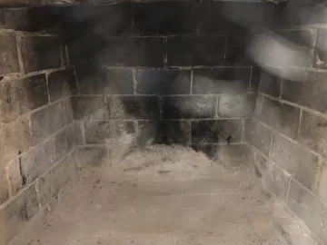

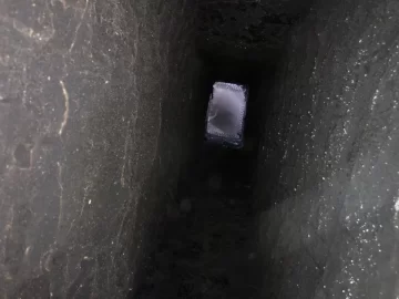

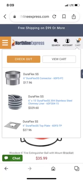

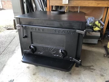

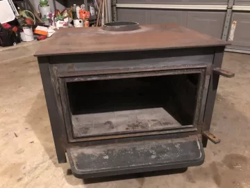

I have what is now a free standing stove that will go in front of our masonry fireplace. Chimney is unlined and wide open. 6” diameter should draw properly based on the stove size, but it does have an 8” collar.
So…I know stainless flex may be the best long term option, but we’re not 100% how this will heat. If we will like it, or if it will draw properly. Would I be stupid to use cheap black stove pipe to try this setup out?
One room rock / concrete cabin. I’ll find more pics. How would you plumb this up if it were you?
