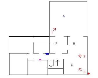

I've been reading the forum for a few months now, especially all afternoon today in hopes to find a good post that would help me answer my questions, but no luck. I bought a Harman P43 last year and I love it, however my wife and I were disappointed with the heat distribution throughout our house. We would find that our family room would get really hot, but the rest of the house would not. So I found a point where the stove and furnace would work together last winter, but gas prices are jumping up this year and I didn't just buy 4 ton of pellets for one room! I attached a paint drawing of my house in hopes I can get some good advice on it.
My house is a split entry, pretty well insulated. This is on the top floor
Room A - Family Room - Addition to the house...The furnace vents were not balance so this room is usually colder than the rest of the house and this room has Cathedral ceilings
Room B - Dining Room
Room C - Living Room
Room D - Kitchen
Purple Dot - Thermostat
Blue Dot - Cold Air Return
Red Dot - Natural Gas Meter
#1 - Initial position, #3 - Best recommended for even distribution, #2 - Realistic placement because of the gas meter
Can I place it at #3 and route the vent away from the gas meter? is that ok?
If I was to place it at #2, would the heat still reach Room A?
The exterior wall faces the wind, should I be concerned about heavy winds blowing back into my exhaust? what about an OAK?

I`d put it in the family room since it has cathedral ceils , 3 exterior walls , and is already the coldest room.
Some warm air should enter into the kitchen and din area. If you put it in the Liv rm any warm air that possibly manages to reach into the family room is going straight up to the cath ceiling anyway so you won`t benefit much there.

might want to place stove at #2 , with a box fan in that room poiinting down the hall, a doorfan from btoa, maybe dtoa,
and possibly doorway fans in those other rooms. the fact you are using cold air return helps immensely,

what in the top right corner? (A, top right).
That to me seems like the best place. it's in the coldest room, and it will be aiming on the angle out towards the hallway.
Yes, placed in either one of the 2 corners (top of diagram) or even in the center of that outside end wall, IMO would be suitable.
The Top right corner of A is the TV... which can be moved. my concern with keeping it in room A is that the air flow between that room and the rest of the house is bad. The Cathedral ceiling in that room also makes it hard to move heat from that room. Im also thinking that by putting it in room C (living room) it will be close enough to the cold air return (blue dot) that it will cycle some of the pellet stove heat to the rest of the house (basement especially)
If the family room gets hot what do you think the living room will be like with the stove there? Your expectations might have been too high since your layout doesn`t look to be ideal even for a large pellet stove (still only a space heater) to heat the whole house reasonably evenly.
My advice is to quit looking at the pellet stove as a whole house heater and utilize it as supplemental. Why not just turn it down and use it to heat that cold family room only (looks to be 1/3rd of the living space ) or devise a way(S) to move the extra heat that it is capable of , down off that ceiling and out of that room. The cath ceil don`t help things but you`re stuck with it and gotta deal with it one way or another. I assume that room is zoned separately .

I figured it was too small. I think my house is about 200 square feet too big for it to heat it entirely. I was just look to get some extra input on how to make the best of my pellet stove of it so my furnace doesn't have to burn gas much, and so the heat is as evenly distributed as possible. Anyway, If I was to put it at #3 would I be able to route the pipe away from the gas meter or would that be a no-no? I don't care too much if that room is like an oven.
If it were me, I'd be putting the stove in the corner of Rm A that is "above" (in the diagram) your 1st choice. Putting the stove catty-corner aimed directly toward the doorway to Rm B ....this will help somewhat in sending it toward Rm C too.
It also takes any issues w/ natural gas meter completely out of play & heats the coldest room 1st.

Question: which wall (as per the diagram) is the one that has the (prevailing) wind hitting it the most?
North would be the front of the house (which is where the living room, Room C) is. the Prevailing wind hits the right side of the house if your looking at the picture. The house is fairly well insulated, and the windows are newer... however the doors are older and don't have the best seal. There is also 1 window in the family room that was a factory defect and so it does not close straight. I did notice a draft coming from these places last year when I had the stove running.

Then the next best spot (IMO) is the other corner (upper right of Rm a) and face it directly toward the rm b doorway. The idea is to heat rm a first, and also be pushing the heated air toward other rooms via doorways.
