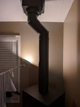

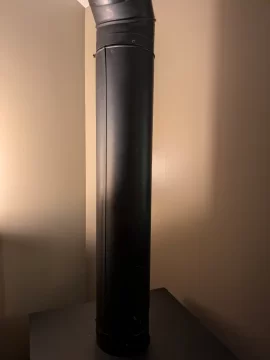

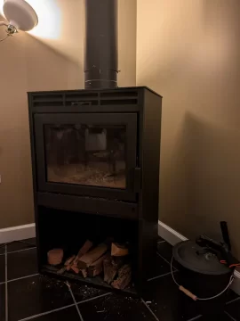

[Hearth.com] Stove Pipe Won't Stop Off-Gassing [Hearth.com] Stove Pipe Won't Stop Off-Gassing [Hearth.com] Stove Pipe Won't Stop Off-Gassing [Hearth.com] Stove Pipe Won't Stop Off-Gassing

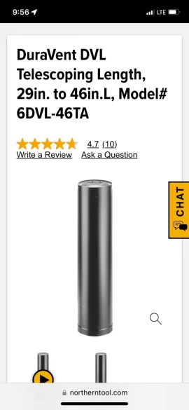

I'm not sure what exactly to send, just ask for details. He never got back to me about the model of the pipe... as is typical for him, he seems very done with this job. I'll try calling tomorrow.
You make a great point, it shouldn't be off-gassing at 190⁰ F. So we're thinking defective pipe or defective paint, because one means I need to replace the pipe and the other means I can just sandblast.
Will definitely update everyone soon when I find out what pipe it is! I'll try calling the manufacturer also.
By the way, is the pipe supposed to look kind of matte like this? The paint on the stove is so much nicer than what's on the pipe.
Here it is. Top of the line he says.
