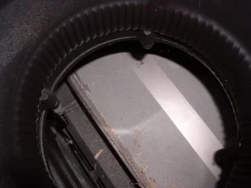

summit said:trim about one inch or so off the crimps on your pipe adaptor: we run into this all the time with jotuls and VC stoves... the flue outlet is usually set to recieve a crimped end at about 1" long, but ofthen time factory crimps are 2" long... a pair of snips will cut it down, and looks better than smearing cement around the seam.
Highbeam said:Looks like hearthstone is still using the cotterpins to hold the ceramic baffle to the secondary tubes. What a pain. I thought they had gone to wire though that does seem like a redneck fix.
