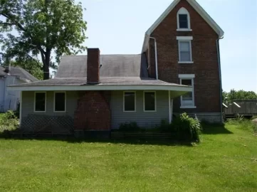

here's the chimney in question. I can't really tell you exactly how tall anything is, but I do know that those windows are about 4 inches from the ceiling and I'm guessing the ceiling to be at 6'6" right where it meets the wall. The floor level in the room is about where you can see the green painted cement meeting the bricks on the chimney.
So i figure the total length of the floor to chimney top is about 13 feet. take off 3-4" for hearth, take off another 28 inches or so for stove height and you've got 13' minus 32", so about 10+ feet from stove top to chimney top.

Don't know what stove you are installing, but the manual for my Englander 13 states the minimum height of the flue is at least 15' from the floor of the hearth.
Al
yeah, I'm pretty sure mine says something similar, but I AM putting an extra bit of Class A up on top of the chimney as well. I figure I can get another 6ft up there for a better draft.
