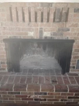

I don't understand why I find myself so confused on the installation process of putting a stove insert I swooped in on, into my current Fireplace that is "open" I suppose.

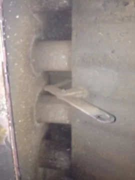

I have a rather larger fireplace that is brick that extends through attic and out the roof. The fireplace has a blower set up and has 2 fans on each side. The air is pushed out above the fireplace through some slotted brick. This set up has 3 pipes the cut across my flue I belive is the word.
I came a across a 1984 Lopi LX wood stove insert. This monster fits in the fire place very well and appears to possible be overkill for my 1600sqft home.
My question is why can't I just have the exhaust leave the stove and head up the chimney?
I'm having a custom frame/shroud built to cover up the gaps and will insulate to seal off the chimney from the living room.

You need a liner run from the stove to the top of the chimney. They type of install you are talking about is referred to as a slammer and it is no longer to code. The problems are that it is next to impossible to clean it properly the flue is masssivly oversized leading to poor draft and excessive creosote. and it is just plain dangerous
