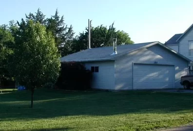

Lets make an unofficial list: (let all add)
Stove off the floor 24"
Out side air kit supply to the stove
leget stove install like as if it was in a home with leget chimney
Stove in its own space away from everything else
wood supple / other stored outside or contained
no storage around the stove
Combustibles ( paint ect ) other side of shop in its own room or storage cabinet.
All used rags and towels in a fireprotection metal can/bucket with lid
New rags and towels in a cabinet or contained area
no loose insulation (paper backing)
no gas and or other flammables of storage in shop
keep all cloths / jackets / gloves other stored in contained closet / area
Keep floors areas clean of junk well sweeped / espectally woodworking
pull out items away from walls to keep sweeped and or blown out - clean
proper ventilation
no exposed wall framing
keep all papers / notebooks ect kept in drawer or other contained cabinet
no storage boxes of cardboard / wood storage
Just a few off the top of my head that i try to strictly in force in my home shop ................

the safest way to heat a garage are
floor radient heat
a zone of Fhw heat or a forced hot water overhead exchanger
the problem with wood stoves they are not sealed combustion chambers. Hey I do plenty of work in my garage just like a lot of folks today I making up 4 cabinet doors.
