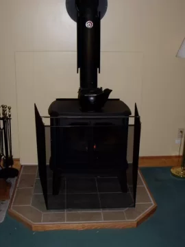

I made up a piece for the top so it can sit against the stove and wont slide further back
I feel the gate would have become a curiosity factor and it is not tall enough to deter them, they would drag a toy box over and climb it, the gate system is VERY short
(broken link removed to http://www.americanchimneysweeps.com/child_guard_woodstove_screen.htm)
I bought mine at a local retailer (display model, got it for $75)
Still going strong.

your screen looks like it has long sides for better stability, most tri folds have short side and tip easy, expecially if the little one is hanging on to it, in wich case can ge dangerous if the screen is heavy and hot. Kidco screens bolt to the wall for added saftey.
I just have the tri-fold for use when my grandkids are here---but if I had a full time child I would go with the one linked above.
Our tri-fold works because I can wedge it around my hearth between a table, etc but I still have to watch my youngest granddaughter like a hawk! Also, with my corner stove I can usually block access to that part of the room as well. Can't be too careful with children.
