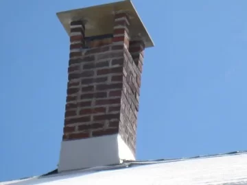

I had my roof re-done 2 years ago and had the brick chimney re-pointed, flashed, capped and scoped with a camera. My roofer said the liner had cracks at the top but wasn't too bad, he "officially" recommended a ss liner be dropped in and personally for piece of mind I have no problem with added safety. I like my roofer (who also sells, services stoves and chimney work), he does good work but is on the higher side with cost. I believe he quoted me 2-3K to drop a liner in my chimney. It's probably 45'.

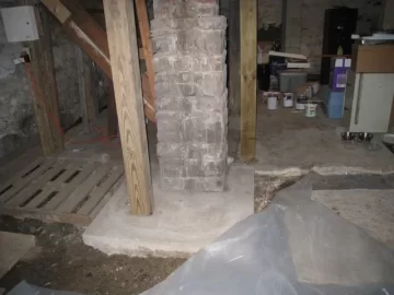

Here are some pics of the basement and the chimney.

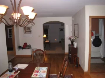

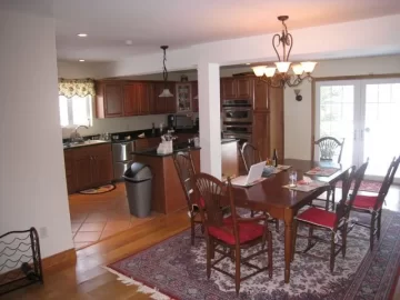

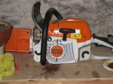

The kitchen/dining room area I want to heat, and my new saw to go with my 025.

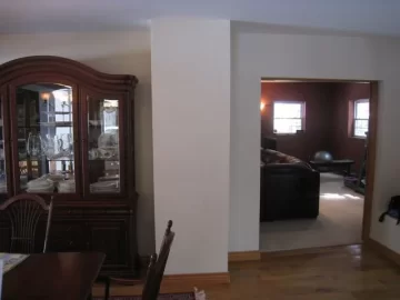

What is the ceiling height in the basement?
Personally, rather than heating the earth, I'd want a big, close clearance stove upstairs where it can be seen and felt. How about moving over the workout stuff and put the stove where the silver ball is?
Is that the chimney right next to the china cabinet? It looks like you could fit a stove there, if you wanted, and poke a hole through.
The ceiling height is about 6' in the basement.
Yes, that is the chimney next to the china cabinet, and I've thought about that option.

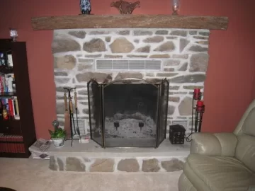

The room with the treadmill and such has an existing fireplace, which I light for aesthetics only (picture below).

Very nice. Have you thought about putting an insert in the fireplace?

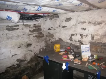

I have my workbench down there for ski tuning and I'd tie some flies down there if I didn't catch such an awful chill when I do work down there. When I wax skis down in my dungeon (as I like to refer to it) I don't have to wait very long for the wax to harden, but I feel like I have arthritis when I'm done.

Well, I was thinking only the insert. The low ceiling has me concerned a bit. Insulated floor is going to make it harder for heat to seep up there too. For the ski work I would just use an electric heater when down there.
A nice Jotul or Hampton insert would go with the place, but that would depend on what would fit. We'll need the fireplace opening dimensions plus it's depth to narrow down options. Are there other stove locations that might work that connect with the kitchen/dining area?
That looks like a decent sized (pocket door) opening to the kitchen/dining area. If necessary, a fan placed on the floor right about where that black rack is in the diningroom pointed toward the fireplace room would balance out the heat. Blowing cool air towards the warmth works quite well. A simple table fan running on low speed would work.
Thanks BeGreen.
The fireplace dimensions are:
29.5" H at the opening
34" W at the opening
25" D
27.5" W at the back of the firebox

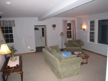

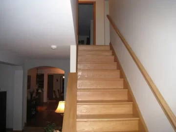

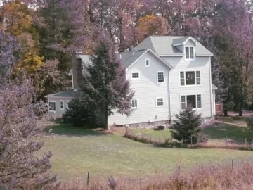

Here are some other pictures of the house layout. Hopefully, you can see where the fireplace chimney is in relation to the whole house. I'm terrible at describing stuff so hopefully these pictures help.

Looks like there have been a few additions over the years. A stove in the core of the house is going to provide the most satisfying results. For this part of the house it looks like the dining room would be the most effective. It could tap into the chimney with a stainless liner in it. However, I'm guessing that would be somewhat disruptive to the room. The living room is another candidate, but it will need a new flue and it appears to be a 2 story + attic run. Is that ok?
So that brings us back to the exercise room. For the fireplace I would look at the Jotul F450, the Hampton HI300, the Hearthstone Clydesdale, and the Pacific Energy Alderlea T5 inserts. These are all medium sized inserts. They won't heat the joint, but they will keep that area cozy. The fan suggestion mentioned in the previous post will make a big difference in evening out the temperatures.

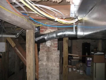

Where is the furnace located? Is it in the new part and is there a higher ceiling there?

No, the furnace is located in the old area. The addition was built over a crawl space. I assume the original heat source for this house was wood or coal and tied into that chimney.
I just measured the ceiling height, from the cement pad to the floor joists is 75" and to the actual floor is 85". Again, this section is not insulated.

Looks like a perfect fit for a wood furnace with the duct work running right beside the chimney He could heat is whole house instead of just a few rooms.
Looks like plenty of room for a furnace if you set it on the floor.
