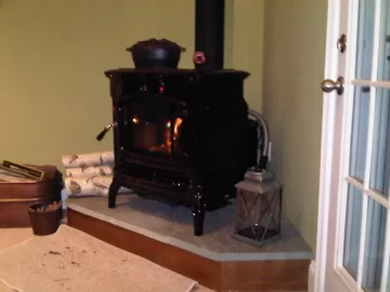

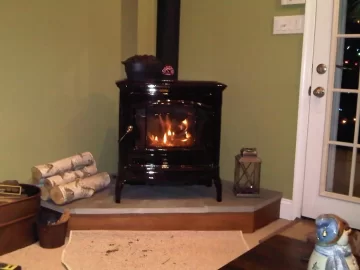

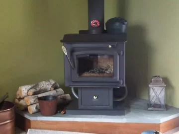

Thanks for the quick answers. I didnt actually make an even trade I wish. I just had to get the wife to the local dealer to see what a new one looked like and thats all it took. We window shopped on saturday and went back and got it on sunday. Put the old one on craigslist sunday morning for $450 (Think i paid just under $500 for it 4 years ago) sold it for $400 sunday night. Cant beat that! People are still calling me to see if i still have it. Anyway here are some pics. Thanks again!

The Shelburne is one of my favorite stoves. I like my Jotul Castine, but sometimes I wish I had gone for the slightly larger Shelburne. I think it is a sharp looking stove that is made in VT too. Nice pics. Stove looks good. Your setup looks fine. If you meet the clearances specified, I'd just leave it alone.

Don't want to be too picky, but doesn't piling firewood that close to the stove (in your photos) defeat the purpose of the "minimum clearances to combustibles"? (Full disclosure: I've owned a couple of pellet stoves, but never a woodstove...Shelburne on order, in brown enamel. Is that what you have?)

I am getting rid of that pile of wood it was only for looks. It was always cool to the touch when i had the old stove in.But the new stove puts a whole lot more heat. And yes it is a shelburne in brown enamel.

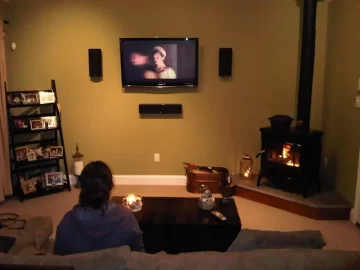

Here is a picture before i put up the dry stack stone vaneer. I will post a pic when i am done so you guys can let me know what you think. Since this will be my first time installing Vaneers, but i did watch the guy who did the front of my house and i should've done it my self and saved some money.

What about clearence on the front of the stove? looks like the stove is a little close to the edge in the pics
I Have a fire rug that is goes in front. Is that good enough? I was thinking about putting tile down in front of the stove if i need to. Thanks for the input.

I'm thinking that most folks would recommend an actual hearth and not just a fire rug.
Make that the manufacturer requires a full 16" of R .8 hearth in front of the glass. A hearth rug is not an acceptable substitute here.
A floor protector with an R-value of 0.8 or
more that you obtain from your dealer. A
floor protector is any noncombustible
surface laid on the floor underneath the
stove that extends, 16 inches -US (46 cm -
CA) beyond the front door and 8 inches (203
mm) beyond each side of the fuel loading
and ash removal opening(s).
Also, is the stove connected with single-wall pipe? Hard to tell from the picture, but looks like it. That requires 18" clearance from the walls.
