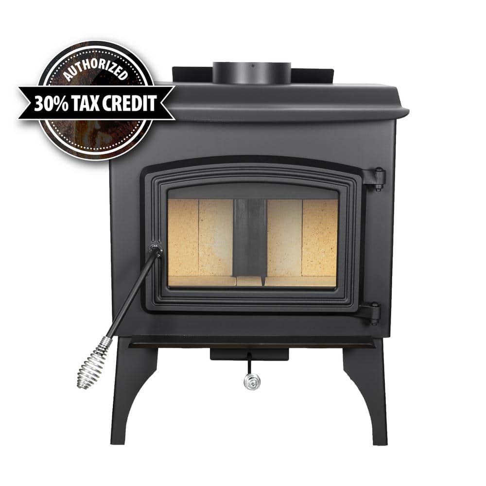

It’s also ember only, so I stole some 3/16”steel from a welder I know and painted it black.
I think it’s advertised at 400-1200sqf.
[Hearth.com] Stove Clearances
What is the Aspen C3 selling for these days?
$1800. I might have missed if there was a budget we were shooting for.
