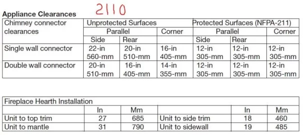

Would like to have this stove; wife even likes it. Bigger than what we need. Big problem is the clearances required.
Basic Clearance
(using single wall pipe top vent)
Stove to side wall 18"
Stove to rear wall 17"
Stove to corner 13"
We have a pretty small house, 1650 sq ft for top floor and our area where this stove would be requires that it be as close to the wall as possible. If I stud the wall with metal studs, use a non-combustible type of wall, how close to the wall would I be able to get this?
And, does anyone think I'm OVERDOING it by going with a stove this large for our semi-small house?
