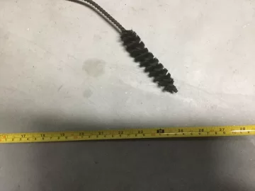

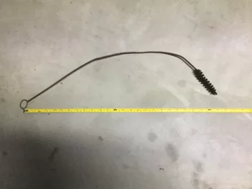

I replaced my P24FS last year after 17 years of faithful service. I'll give you one tip on this particular stove (or at least I'll try!). Behind the ash pan there is a piece of metal that you can slide up and off. Remove that door to access the hardest part of the stove to clean. Push a narrow brush up the left side until you see the brush head inside the main part of the stove, top left corner by the bricks on the back wall. It is a narrow passage right behind that door, push the brush all the way left then up. All the way up. You will have to stick your hand in there to feel your way around. Run the brush in and out a few times making sure your vacuum nozzle is where you stick the brush in to catch all the ash you pull out. Do the same for the right side. You need to really push that brush, wiggle it around. Grab a flashlight and look for the top of the brush in the stove. You can stick your finger into the hole where the brush come out, make sure it feels clean. I would recommend once per ton. I had my stove cleaned one time professionally and it was the first time it was cleaned. Caused a very lazy flame. I hope I explained it right. I can't show you pictures as I don't have that stove anymore. This is the brush I used. I also used this to clean the heat exchanger tubes. What a project, and mess! One of the big reasons I bought my Harman!
I seem to have a slightly different model. There is no ash pan/drawer under the stove. The stand is one piece of sheet metal that goes all the way around.
I did encounter that integrated heat exchanger cleaner. Though I don't have the tool to operate it, I had to stick my arm in there, and I see why there's a tool for that. Got my arm covered in ash. Also got my blower sorted out (for now, until I can buy a new one)
