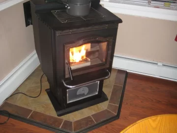

nothing to worry about. but, I do have the accessory shields on both sides..
  • [Hearth.com] Storing Pellets in proximity to Stove
