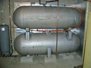

I'm have two 250 gal. tank stacked one on top of the other. I have been up and running for 6 weeks making hot water and some heat. I used the holes that were in the tanks, hot in the top and cold out the bottom. Come over and check it out. Very simple set up.

Great info thanx. It looks like vertically in sequence is the way to go.
Now I have to find a welder that will install fittings in the ends of the tanks.
I'd appreciate any schematics, drawings, or photos explaining the best way to handle this.
