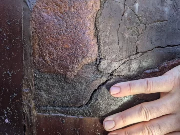

Below are images of my chimney. I'm guessing this is the original stonework when the previous owner had the house built 33 yrs ago. I am seeing some cracks starting to form where the condensation runs down the chimney in the dead of winter. I noticed this last winter there was a decent amount of ice built up on the backside of the chimney. The Wood stove is a 1980:s blaze King. Should I just get some type of topcoat mortar to fill in the cracks to keep the water/freezing cycling from going farther into the stone work?
View attachment 284820 View attachment 284819
Just a top coat won't do anything you need to remove the old mortar and replace it.
