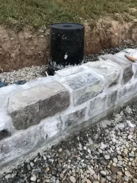

33177C22-9FE8-41A1-AA95-9BA5AB1CFF33.jpeg There is a learning curve with this that I am picking up on. By the time I am done, it might be ok.
None of the stones are consistent so there’s a lot of piecing together and mortar.
