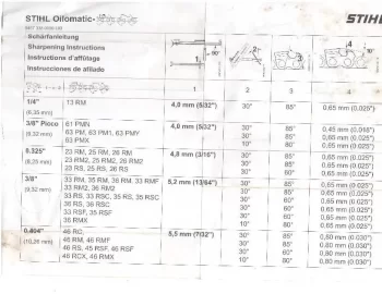

For .325 pitch chain, the same 3/16 round file works for chisel, semi-chisel, "pro," and safety chains. The .325 Stihl file guide also will work with all those chains.
I prefer to carry extra chains into the field and swap them, but I will file in the field from time to time. I still use a file guide to get the proper depth, and stump vise is very handy.
I just so happen to have a chain file guide info sheet in front of me ;-)
