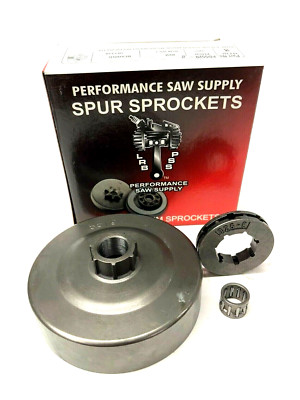

Does the 311 have a spur clutch or rim drive? and same question on the 029. As that would make it an easy swap. As i have not had a 311 yet just take off both clutches and compare if they are not rim drives.

A spur drive clutch has the teeth that drive the chain as part of the clutch drum. When the teeth are wore out you have to replace the complete clutch drum.
A rim drive clutch has a replaceable gear that drives the chain, when it's wore out you can by a new gear for less than half of a spur drive,plus you can change the gear to any chain configuration like 325 3/8 or 404 without changing the clutch drum. Plus you can change the size of the gear most common is 8 pin,go down to a 7 pin if your saw is having issues cutting or go up to a 9 pin if you have more power than you need for the wood you are cutting.
All is done without having to remove or replace the clutch drum,just the gear. Unless it is an outboard clutch.
Assuming the splines are the same size. ==c I went though that with an old 10-10S I am playing with. I wanted to convert it to a 0.325 9T sprocket from a 3/8 7T. I couldn't find a .325 9T in the small spline, only the large spline, so I had to buy a new clutch drum that had the larger spline.
Or this
Still not sure about switching the drive sprocket swap but this may help understand what you have.
