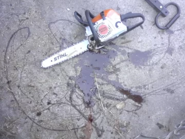

Caps are junk! Twice had the oil cap not take correctly and dump fresh loads of bar oil onto the ground and my boots. Found that the oil cap needs to be turned slightly counter-clockwise first, then clockwise then flip the cap. Gas just clockwise then flip the cap. Or was it the other way around?? POS system. Makes me appreciate the Husqvarna even more. Only bought the Stihl because I ran across a used one for a decent price. Would sell for the same I paid at this point and put it towards another Husky.
Here is the visual of what happens:

Well actually, I have never had a problem with getting the caps in right and staying in, the problem I have is they don't seal tight. I didn't use the saw yesterday or today, and just walked past it setting on the workbench in the garage. Smells like gas and sure enough, the gas cap has been seeping/leaking ever so slightly over the last two days. Didn't even have much gas in it when I put it away the other day, just barely up over the bottom lip of the cap and it still seeps.
