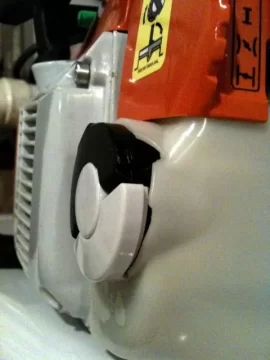

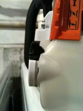

So here are a couple pics of how my gas cap sits. For some reason it just doesn't seem to fit quite as well as the oil cap, and I was wondering if anyone with their saw handy could tell me if this looks right. This is the cap correctly seated and locked. I'd swear there's a bit of broken plastic on the tank, but perhaps that's just how they look.

That looks a little crooked to me but I go by touch I can fill it in my hand when its right.

There are 2 moving parts to the cap. Unscrew it and inspect. You might notice that the 2 parts are misaligned. Holding the top (the flippy part) firm, twist the bottom...and they should realign. Not always. Your o-ring might be the culprit too.
If all else fails, your dealer will be more than happy to sell you a replacement cap. At about $10 apiece, stihl's got a pretty good racket goin on.
Bottom line is don't overfill and you'll be fine and this unneeded and overengineered aspect of the saw's design won't cause you any problems.

The key is after fueling up, watch when you close the cap. Watch the inside part; when it is right (in the notch) and you keep turning, the bottom part of that cap will not move but the top part does. When this happens, you have a good close.
Yes, I had it happen just a couple days ago and wondered why so played around with it. Hopefully that will be the last time it happens.
I love the "Flippy Caps", but you have to study them a bit to understand how they lock. Take one out and twist it and you will see how it operates and then you should not have any more troubles.
