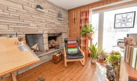

HI, so my family bought a house and my room will have a fireplace in it. I have never used or seen a fireplace being used and since it will be in my room, i have a few questions about fireplace. My main concern is, the rest of my family is not too fond of the smell of burning wood and i don't really want all my possessions smelling like burnt wood, is there any way to contain most of the smoke and not have the smell spread everywhere? I really enjoy the smell of burning wood but don't want everything in my room to smell like it. If the smoke and smell cant really be contained then i most likely will not be able to use it at all so that is very important. Next issue would be: i have read around that a chimney should usually be cleaned once a year (typicially right before the summer when fireplaces stop being used). Is that correct? if so, how much does cleaning the chimney usually cost? I live in southern Ontario, Canada if that helps you guys get an idea of how much it would cost me. I linked a picture of the fireplace so you guys have an idea of what ill be dealing with. The hole on the left is just space to store wood and the one on the right is the actual fireplace

I'm not sure how the Canadian codes read, but here our code states your Hearth extensions shall extend at least 16 inches in front of the fireplace.

Not sure if there is a Stainless Chimney liner in the flue, that will be something that you will probably need also.
Your wood being well seasoned (dry) and having a good draft will be one of the main factors in reducing smoke out of the house. Possibly adding glass doors could greatly help.

OK first off when you say your room do you mean your bedroom? If so atleast in the us you are not allowed to have a wood burning appliance in a bedroom that includes fireplaces. Now I know many houses especially old houses do have fireplaces in bedrooms but it is not a great idea to use them.
Now as far as smoke smell if it is designed and working properly you should have little to no smell in the room at all. If there is smoke or smell in the room something is not working properly. I agree with the previous post I would have a pro out to do full inspection and they could at that time walk you through operating the fireplace. The frequency of cleaning depends entirely upon how much wood you burn. Generally in an open fireplace the recommendation is to have it checked after a chord of wood is burnt through it. If you are using good dry wood and the fireplace is designed well you probably wont need it cleaned after a cord but you should check it just to be sure and to get some understanding of how much buildup you are getting. We have some customers who need it done once a year and some who go 5 years. Average for an open fireplace the way most people use them is about every 3 years. But again that depends on your usage.

A properly built fireplace and chimney should not smoke, other than just an occasional hint of wood smoke the only time you should be able to smell smoke is when you go outside. Unfortunately a lot of fireplaces and chimneys are not built well and are sometimes unsafe. There’s in interaction between the firebox, smoke chamber and flue. There has to be a smooth transition and a good draft from the fireplace opening all the way to the top of the chimney. I use my fireplace regularly without any smoking problems. It is a typical fireplace/chimney you’ll find in an early 1950’s cape, nothing special just built well with the proper proportions. An experienced mason should be able to tell by looking up the chimney weather of not it was built properly but the only sure way you’ll find out is to use it. Unfortunately if it wasn’t built properly there isn’t much you can do unless it just requires extension of the chimney. Sometimes they just didn’t go high enough. After the burning season you may get some smokey smell from the firebox especially if it gets humid.
Your hearth is definitely not deep enough.

By looking at your pic posted, I could tell that the old owner use to use that fire place (all the black smoke stains) so with it being summer and all does the room have any type of fire place smell? if it doesn't you may have a good draft in the summer months which only gets better once it gets cooler out, also you can try taking incense sticks and once the damper is opened watch were the smoke goes, should be sucking into the fire box and up the smoke shelf.
