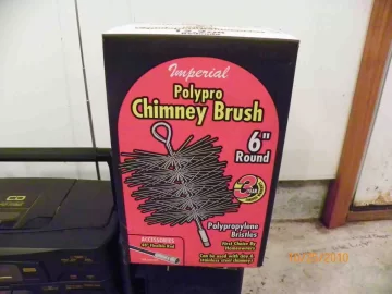

As most know after so many lingering debates, I normally use a Rutland steel chimney sweeping brush.
This summer, I saw a poly brush and said, ah to hell with it, gonna try it.

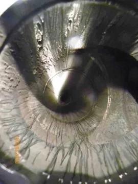

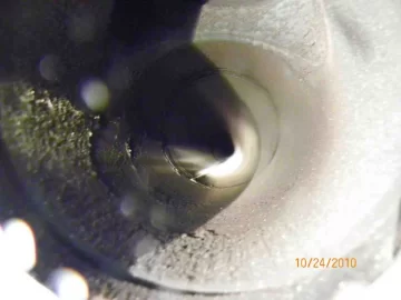

So i put the poly to work, giving the steel a rest this year. From what I read in the past, I expected the poly to be a lil tighter than the steel, especially when I got down to the 5' flex section at the bottom.
To my surprise, the poly was a much looser fit, which actually made for more work for me, more wiggling, turning and trying to get a good scrap of the bristles against the interior of the pipe.
In my case, the poly also did not clean as well as the steel does. leaving a very thin black coating, almost like a stain on the inside wall of the piping.
The steel would leave not spotless, but no single layer, just a few brush scrub streaks etc.
Now maybe it is better not to get as close as the steel does, for fear of wearing the piping or protective layer/coating etc. But definitely gets cleaner and closer.
