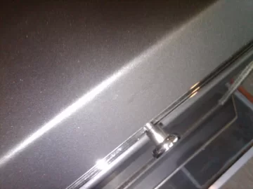

Well some blemishes are in spots that are much more noticeable and we would like to see them fixed! See pic 1 - blemish to repair.
So does anyone have a good way to fix a spot without re-doing the whole stove?
This stove is very new so it does not require a complete re-do!

Pic 1 - Blemish to repair. Right in front above the cleaning knob and a little to the right! A very noticeable spot!
